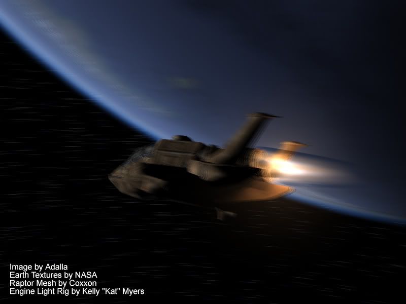

Test render on what is actually a Viper engine light rig which I've attached to the Raptor for now to test it.
And right now I gotta fix the problem on the image below:
As you can see something that shouldnt be happening is happening around the engine exhaust. If anyone knows what it is, let me know pls

looks like banding in the light rig. see if this tut helps. Using Vector Motion Blur - Tutorials - LightWave 3DŽ

Thanx m8. Though I dont think that's the problem. I've been trying to figure this out for...well longer than it's good for me lol and I think the problem is the interaction between the exhaust lights and the spill light.
Here is a shot with the lights seperated, and you can see the left exhaust is fine, the right exhaust has issues when it interacts with the spill light.
When I remove the spill light, it looks better, though you can still see some of the light's countour.
If anyone has any idea how to fix this (again, this is Lightwave) let me know pls
